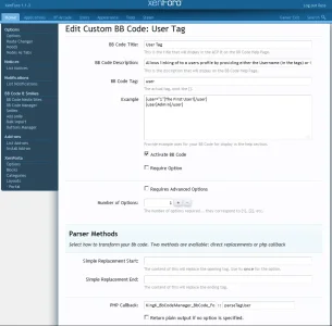

Getting this error out of no where:
Fatal error: Method XenForo_BbCode_TextWrapper::__toString() must not throw an exception in /public_html/library/DigitalPointAdPositioning/ViewPublic/Thread/View.php on line 29
Any ideas at all? Haven't changed any plugins that I know of since I installed and it was working fine up until someone pointed it out to me today.

Any chance you could disable the custom ones just as a test to see if the error from calling __ToString() goes away? Might be able to help track down exactly what the issue is.
One by one it appears to be the User Tag, disabling that by itself allows the page to load with no errors:
^ How it's currently setup, looks like I'll be asking over there, thanks (y)
