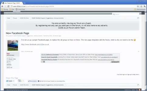

I've not noticed a drop off in clicks on my forum. I also have the same add at the bottom of the forum under the breadcrumbs, which is visible all the time.
