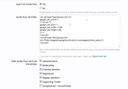

Settings

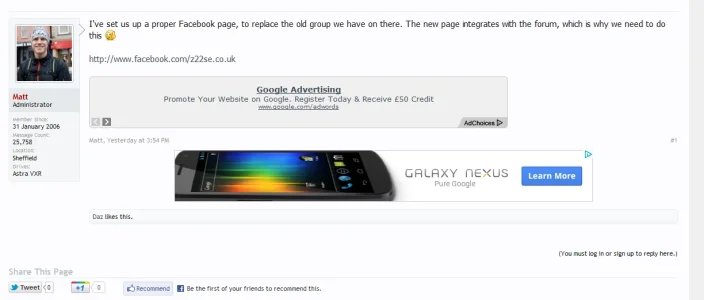

Logged out displays both inside post and under post (don't normally have inside post set up, just testing for this thread)

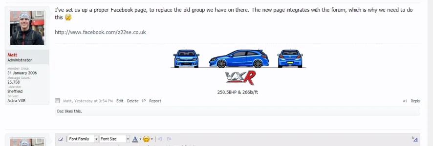

Logged in (no ads displayed)
