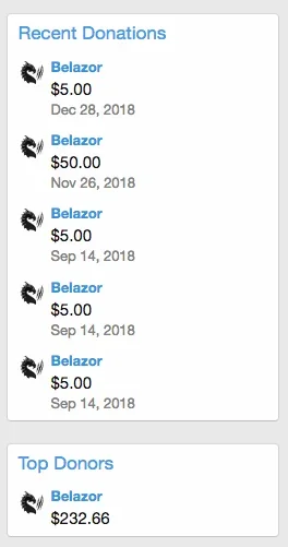

This version features mostly back-end only changes to make it compatible with XenForo 2.1, although there are some front-facing changes as well.
The Recent and Top donators widgets have been updated to a cleaner design and to add avatars, taking anonymity and whether the viewer is ignoring the donator into account.
Complete Change Log
Change: Improved PHP 7.3 compatibility
Change: Updated widgets to feature avatars and a...

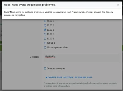

I am facing a strange issue with 3.1.0 Release Candidate 6, XF 2.07
Only for a specific user, when this user try to make a donation the following message occurs :
Oops we met an error ...etc
This user is part of a specific group "premium". I tried with other member of this group but did not met the issue.
  • Error: Call to a member function convertToPrimary() on null
  • src/addons/DBTech/Donate/Entity/Donation.php:132
  • Generated by: dominiquelouise
  • Jan 27, 2019 at 10:12 AM
Stack trace
#0 src/addons/DBTech/Donate/Entity/Donation.php(296): DBTech\Donate\Entity\Donation->recalculateUserAmounts()
#1 src/XF/Mvc/Entity/Entity.php(1145): DBTech\Donate\Entity\Donation->_postSave()
#2 src/addons/DBTech/Donate/Purchasable/Donation.php(126): XF\Mvc\Entity\Entity->save()
#3 src/XF/Pub/Controller/Purchase.php(21): DBTech\Donate\Purchasable\Donation->getPurchaseFromRequest(Object(XF\Http\Request), Object(XenConcept\ConversationCategory\XF\Entity\User), NULL)
#4 src/XF/Mvc/Dispatcher.php(249): XF\Pub\Controller\Purchase->actionIndex(Object(XF\Mvc\ParameterBag))
#5 src/XF/Mvc/Dispatcher.php(88): XF\Mvc\Dispatcher->dispatchClass('XF:purchase', 'Index', 'json', Object(XF\Mvc\ParameterBag), '', Object(XF\Pub\Controller\Purchase), NULL)
#6 src/XF/Mvc/Dispatcher.php(41): XF\Mvc\Dispatcher->dispatchLoop(Object(XF\Mvc\RouteMatch))
#7 src/XF/App.php(1931): XF\Mvc\Dispatcher->run()
#8 src/XF.php(328): XF\App->run()
#9 index.php(13): XF::runApp('XF\\Pub\\App')
#10 {main}
Thank you.
Request state
array(4) {
["url"] => string(51) "/forums/purchase/dbtech_donate_donation/?drive_id=3"
["referrer"] => string(95) "https://www.forum-des-portables-asus.fr/forums/dbtech-donate/drives/soutenir-les-forums-asus.3/"
["_GET"] => array(1) {
["drive_id"] => string(1) "3"
["_POST"] => array(7) {
["donation_option"] => string(1) "4"
["message"] => string(9) "6gycyvyvu"
["payment_profile_id"] => string(1) "1"
["_xfToken"] => string(8) "****"
["_xfRequestUri"] => string(56) "/forums/dbtech-donate/drives/soutenir-les-forums-asus.3/"
Well, this is strange. If i log on this user account, i am facing the same message.
No issue with another account.
I have only one currency setup and there is no other choice in the donation process.

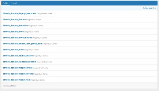

Another issue is when i activate the donation Link after Alert Tab, only administrator is able to see the link :
193700
Can you show a screenshot of how the donation form looks?
That looks like a style conflict then, as there's no different permission checks based on location.
I have reverted all templates to original state, but issue remains, only for this user.. strange.

Sorry, I'm not sure I made myself clear; I mean if you re-download v3.1.0 (non-beta version) and upload it, you'll have the latest files where I don't believe this issue exists.
Ok. Thank you.
I updated.
Still facing the same issue for this user.. i do not understand.
I will leave this as it is and ask him to disconnect and make a donation.
Thanks for your support anyway.
