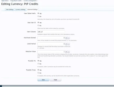

You need to add a transfer event to both the source and the recipient currency. You also need to make sure the currency you wish to transfer from has the Outbound setting set to Yes, and the currency you wish to transfer to has the Inbound setting set to Yes.
That will allow you to transfer from Currency A to Currency B using the exchange rate set in Currency B. If you wish B to be worth half of A, set the Value to 0.5.

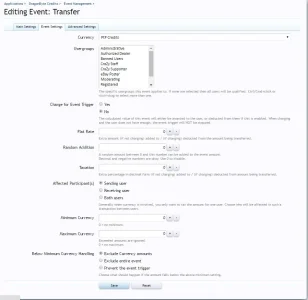

I only have one currency. Here are my settings.

Then I'm not sure what you are trying to do. The Transfer event, as per the event description, is only for transferring between currencies.
Are you trying to allow members to donate to each other? If so, please use a Donate event instead.
Are you trying to allow staff members to add/remove credits from members? If so, please use an Adjust event instead (and make sure the relevant UGs have the correct permissions in XF's usergroup permissions).

Oh! Yeah, my intentions were to allow them to donate to each other. In the old credits system I was using it was called transfer. Sorry!! Thanks for explaining that! :oops:
