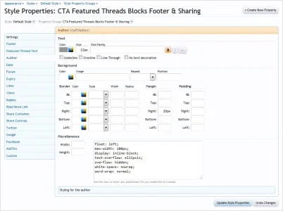

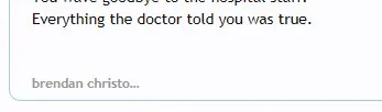

The ellipsis for the author name is due to the max width and overflow here:
Remove the max width if you want names to be displayed in full.
You can also then remove the related overflow lines (the bottom four).
It works.
Make sure you are doing it in the style you are viewing and you have done it for the page and blocks.
It works.
Ah, yes. You are most patient. I thank you for that. Had to do it on the page as well as blocks footer.
