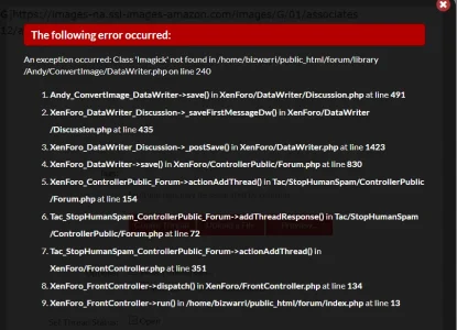

Host just upgraded to PHP 7.1.
Now I get these errors when I try to post with a linked image (using the latest version of your plugin):
I think that means PHP 7.1 needs to be re-compiled with the ImageMagick option... is that correct? Or is your add-on not compatible with PHP 7.1?
If I save the linked image and then upload it from my drive, it posts just fine.
