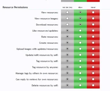

I also want to have different settings to be able to see imags at all. In my forum, only logged in members are allowed to see images. But in RM everybody (even not logged in people) shall be able to see the images within the RM.
Where do I find the code for this?
You can set the permissions for viewing resource images separate from other attachments. That's "View resource images". (And "Download resources".)
However, if you want to change the thumbnail size of the RM thumbs, that would require custom development.
That is strange... I have 2 RM installed on 2 different forums. The settings are exactly the same in ACP. In Installation 1, the images are not visible for unregistered users, in installation 2 they are. What can be the reason for this?
In installation 1 I have a smaller thumbnail size and the image is definitely bigger than that size. In installation 2 the image is smaller then the thumbnail size (so it does not have to get recalculated), in case that does matter..
