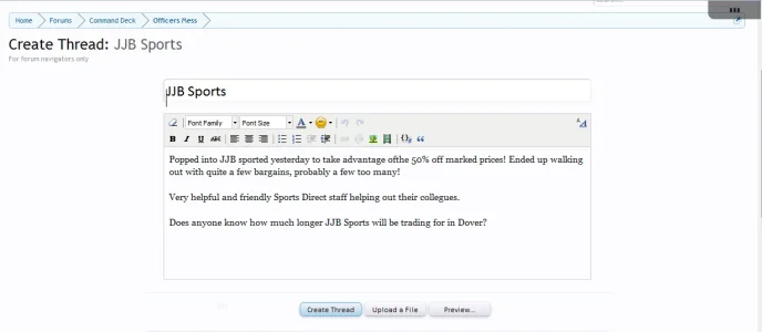

This may seem very strange, but whenever I try and post the following as either a thread or a post, I get an error
Popped into JJB sported yesterday to take advantage ofthe 50% off marked prices! Ended up walking out with quite a few bargains, probably a few too many!
Very helpful and friendly Sports Direct staff helping out their collegues.
Does anyone know how much longer JJB Sports will be trading for in Dover?
This is what happens after I click "Create Thread"

The same problem happens if I paste that quoted text into a post.
How strange that I can create other threads/posts - but cant use that text without getting an error.....

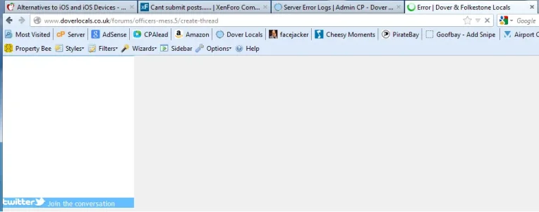

If I disable my twitter mod, then I get the below when I try and submit that text
This stays like this until I cancel. Exactly the same happens when I try and use that text in a post.
