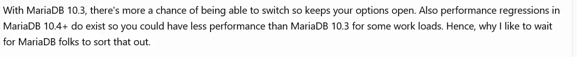

Well, the question was not if MariaDB 10.4+ runs smoothly with XF. It surely does, but as admins who are not good in server management, we have to take everything in consideration. So, since MariaDB 10 came out I didn't have to think twice about running it or updating it to the newest branch. But since 10.4+, now it is not compatible with MySQL anymore, so one is committed from then on. Not that I will ever go to MySQL, but being prepared is always good.
Also, I can't give you details, but if you read eva's posts on his forum, he mentions that there are also some speed problems with the new MariaDB 10.4x branches. So, XF won't have problems running it, but from server-side it seems it is not optimized yet. That is one other reason I stay away from it for now.

My statement was in comparison to MariabDB 10.3. From what I've read from eva, he states that the 10.4+ releases are not as well optimized as the 10.3 release. Of course we are taking about milliseconds here (I think), so nobody sane will ever notice it. But nevertheless waiting for a product to mature always worked out for me. So, that is why I always hesitate. Because unlike you I am not one of those who know how to handle it.
