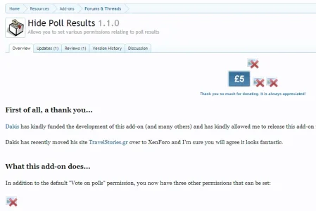

I've been seeing this sporadically throughout XenForo.com:
These images are hosted on Imgur. But they are loading fine generally. I can only assume XenForo cached them during some period of downtime or latency. But if that's the case as these are valid, available images, will they always remain broken?
I actually just tweaked this code. There is a retry mechanism with decreasing frequency. Eventually (currently, after 10 consecutive failures), it will simply stop trying to recache it.
What I just tweaked was how it slowed down. It delays much less up front (only 1 minute after the first failure, for example) so hopefully this should go away more now.
