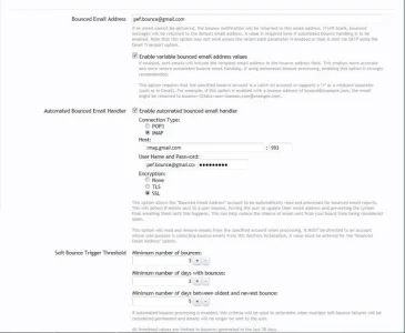

Hi. I'm getting this error. Did I enter the details correctly?
Error Info
Zend_Mail_Protocol_Exception: cannot connect to host; error = Connection timed out (errno = 110 ) - library/Zend/Mail/Protocol/Imap.php:100
Generated By: Unknown Account, 23 minutes ago
