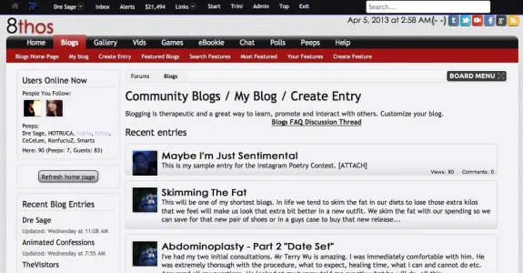

Can you please include blog entry view counts? I just realized there are no view counts!!!
And view count and blog comments number in the blog index for each blog.
For example:
Timely! One of my best blog users just asked the exact same question around 60minutes prior to your post :)
Yes, please.
