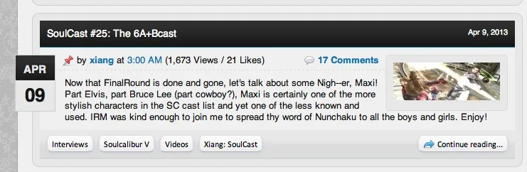

Take a look XenPorta. Here's what I'm trying to do:
I want to put an image on the main blog page (** as an example, I take 8wayrun.com site):
But instead of getting an image on the main blogs list,I get an [ attach ] instead.
So how am I going to insert images that users can see on the main blog index?
I did a smallish patch to blogs, and I changed the rendering on the home page to render everything instead of a snippet. Previously it was limiting the output to 150 characters and parsing no attachments. It will now render the complete entry.
You can find the update on the private downloads section
http://xfaddons.com/index.php?forums/better-blogs.10/
It will be a little simple, though, that XenPorta layout looks a lot nicer. I'd like to improve the home page, so I'll try to get to it. I can't promise a date, though :)
I think this would be the first time for you to download an update, PM me your username at the xfaddons.com website with your paypal transaction number so I can give you access.

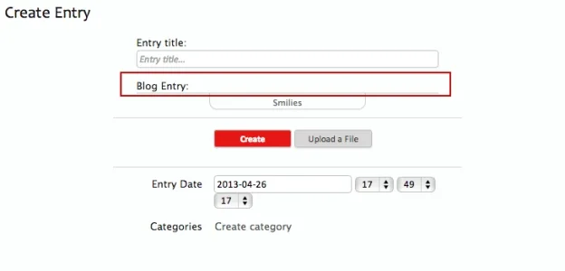

After upgrading to .12, usersare no longer able to add a new blog entry since there is no text entry box for content ...
Need a fix please.
Sorry, Somehow I never got the alert for this.
Someone has the same exact issue with my groups add-on, I wonder if this is colliding with some other add-on. Do you have anything that you think would modify the text area ?
The TinyMCE fix definitely wasn't it, I could not reproduce it on my local box
Could you grant my user in your site (Kentaurus) privileges to create a new entry? I would like to see the error myself and check if there are other associated errors
Done.
I've also discovered that if my site is https (as it is now), then the url's generated for user's blog (multi site) with /admin.php?options/list/xfa_blogs_mult giving no option to define for https. Perhaps you are hardcoding the http prefix for all url's? Can you correct please.
You have a lot of JS errors on your page. And most of them are for an undefined "awesomeTitle", I traced it down to this plugin
http://xenforo.com/community/resources/goodfornothing-title-manipulator-alert-count.871/
I could reproduce it, if I install the plugin on my local box, it breaks blogs.
Oh! :( Wow, thanks very much for finding and identifying this.
And of course when I go to that add-on, I see this post already giving the issue. If only that info had been cross-posted into here too :cautious:
