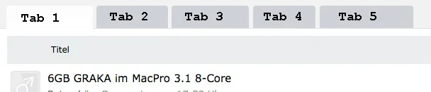

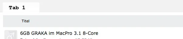

I have a widget group with 5 tabs
How can I hide 4 tabs of this group for guests?
I tried with these conditions. Unfortunately it does not work
You can use widget groups for that. Make one widget for guests and another for members. Both in the same group. Use the conditional field to apply usergroup permissions.
{$visitor.user_id} > 0 (show up for logged in users only)
{$visitor.user_id} == 0 (show up for logged out users only)
