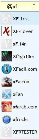

Please add the function that there will be a teaser name appear as Member List area. For example, when we type @J here, there will be Jaxel name appear. Sorry for my bad English but hope you understand me :)
Please see my post xfrocks, thanks :)
