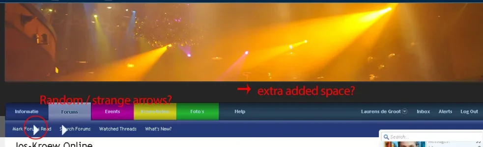

But it still does, see attach. It adds an extra grey bar suddenly and there are strange arrows suddenly appearing.
I have edited the template to remove the control and direction navigation but that is only nivo-slider parameters...
//edit: Okay, I was able to remove the black bar bar removing the theme-default class from the wrapper div...

To remove the arrows, you will need to add some CSS like "display: none" to make them disappear.
