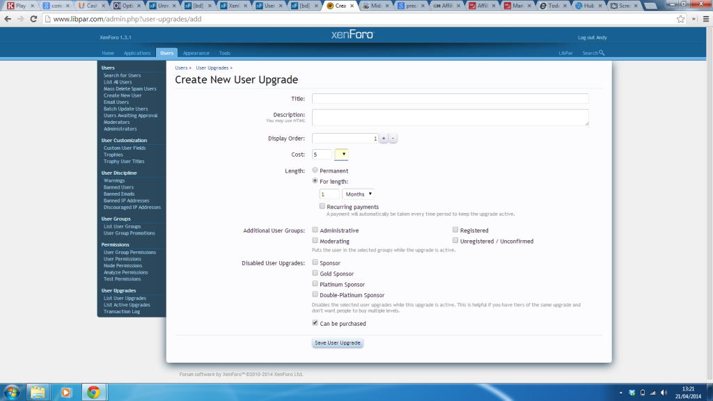

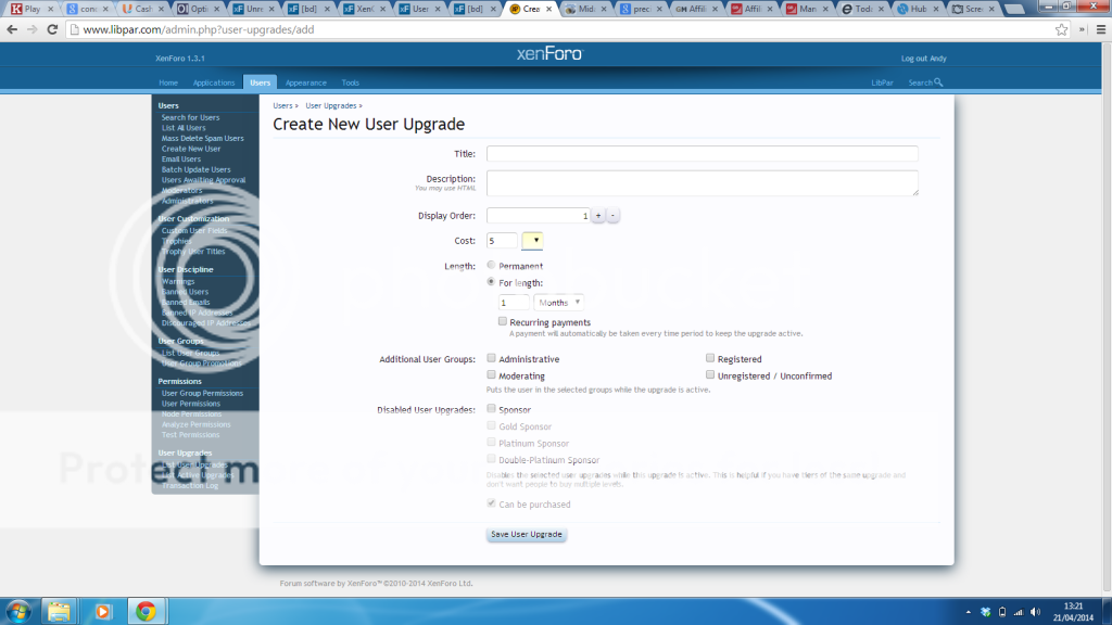

I'm having trouble getting this to work with Bitpay - I've installed this, the bitpay extension, and added the Bitpay key correctly - I think. But now when I create a new user upgrade and set the cost, there's no dropdown to select the currency.
Any ideas what I might be doing wrong?
Just set the price as USD or any other currency. BitPay will convert for you.
