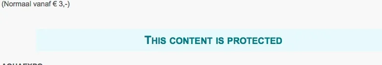

If i put an url in a post, (or a user does) i get as the only admin the following message:
Where can i set this off? The setting for protection is off, but by every url placed in a content i get this. Im running 2.8.0 and xf 1.3.1. If i disable the addon the problem is gone.
Can't reproduce. You might have set a Bbm Bb Code as a "XenForo Url wrapper".

Hi @cclaerhout : I also having the same error with the others. I try to check both of the permission as you mentioned earlier and "Allow" all for the admin. All my Guess, members & moderator are able to see all the links, image posted on the forum. However, i'm admin but only see the error message appeared on any links, img links of my posts and other posts:
"This content is protected"
Please help to fix this issue. :cry:

Send me my pm an access to your board (temp admin account with Bbm admin perms + ftp access).
I already PM to u. Thanks ! :)
I've checked your configuration and I think the result is normal. The misunderstood might come from the way I formulated the permissions. Let's take one of them : "Disable attach Bb Code".
If you select "Allow", it will allow "to disable the attach Bb Code", which means this Bb Code will be disabled. Can you confirm the issue is coming from this?
