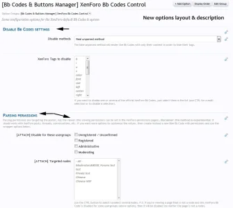

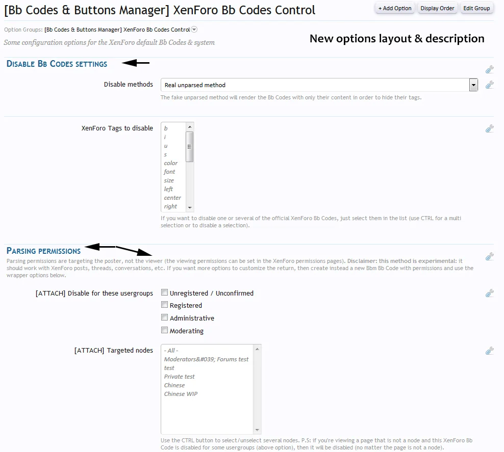

Version 3.3.0 released
This update has mostly been operated by Xon. He focused on the Bb Code pre-cache system (to make it simple, this pre-cache system can be enabled with some Bb Codes that have been coded for to get and cache all data they need in the page from a single database request, then to parse them using the collected data). The page loading time (for one that had a lot of Bb Codes) was reduced from 2s to about 0.7s. A big thank to him.
Changelog:
  • The pre-cache system has been optimized (read above)
  • The tag map routine has been fixed when invalid tags were triggered after the maximum Bb Codes depth limit was reached
  • The code has been tweaked to get rid of an useless section (cf class loader=> already done by PHP) and to assure the tag map remains accurate if other addons modify the view
  • Add permissions (parsing & viewing) for the XenForo Color Bb Code - Requested by Static-Xbox
  • Options layout & description have been modified to make the reading easier
  • A css attribute has been deleted to prevent any display issue with the new responsive admin section
