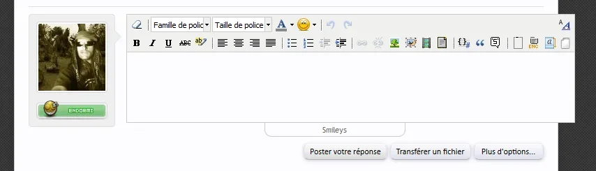

How do i manage to have more than 2 lines in my TinyMCE editor?

I have upgraded this from the old version but cannot get any buttons to show. I have enabled them in the BBM buttons manager but not installed Tinay Quatro yet?
Please read the product description. It has been updated recently. The new version is only to be used with TinyMCE Quattro. Use an older version for TinyMCE 3.x (check again how to do it on the product description - github).
P.S: this addon is also beeing updated for TinyMCE Quattro.

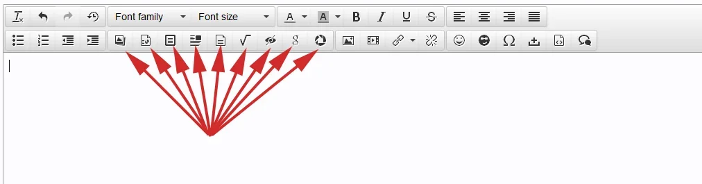

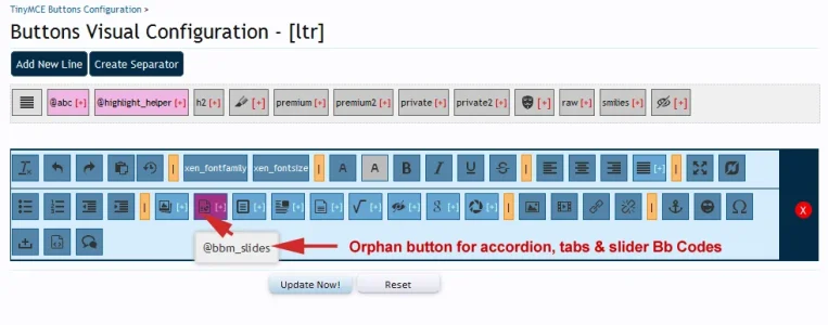

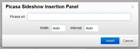

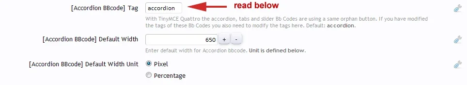

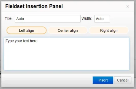

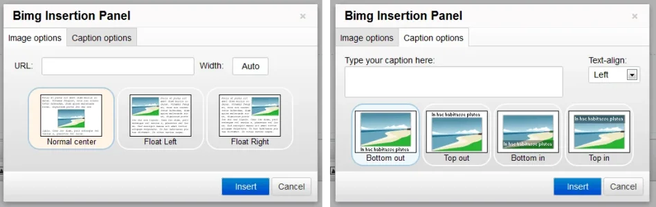

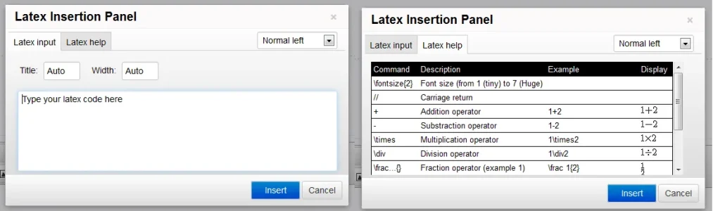

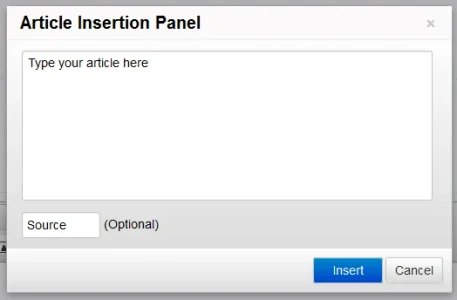

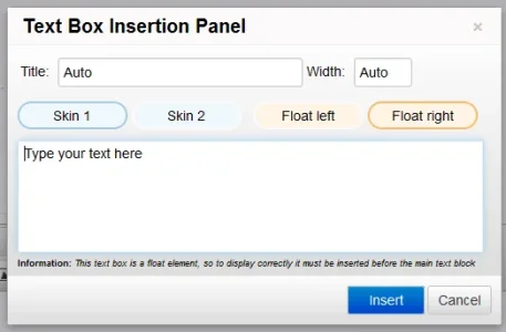

Screenshots for 3.4.0 version.

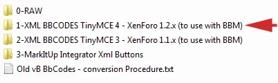

Note: I forget to say that in the extras, you've got Bb Codes bulk xml for TinyMCE 3 (XenForo 1.1.x default editor) and, in another folder, the xml for MCE 4. You need to reimport (use override option) the xml file.
