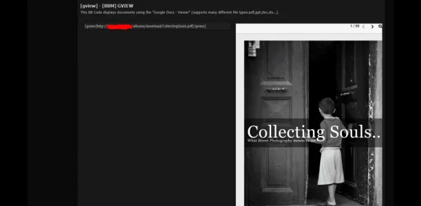

Someone out there who can explain why gview doesn't work?
At the Help Page it is working.

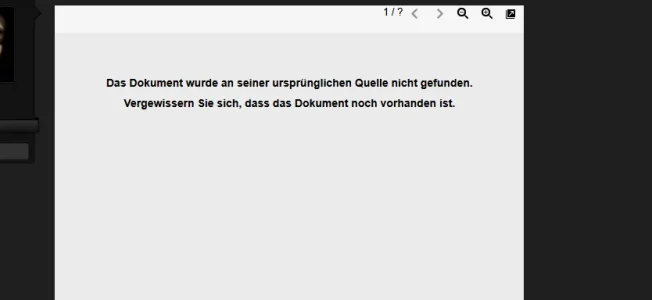

But in Post it looks like that. Use the same document as in Help.
The error message is in German so i translate.
The Document could not be found at the source.
Make sure the Document still exist.
cclaerhout said:
Oh, I know the problem. It's my fault, I've forgotten to disable the autolink in the GVIEW Bb Code config.
Edit the "[BBM] GVIEW" Bb Code, go to "Parser configuration" and modify the option "Stop AutoLinking" to "Disable the autolink in all tag content". It should work after this.
=> I need to update the xml file in the next release to avoid this.
