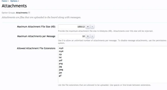

We are having issues uploading attachments over 1M in size and cannot understand why. We get an unspecified error or error message with no details. We have been testing with jpg files specifically and if they are too big it just get rejected.
We have set the limit pretty high and still issues as well tried turning off the flash uploader but that did not help either.

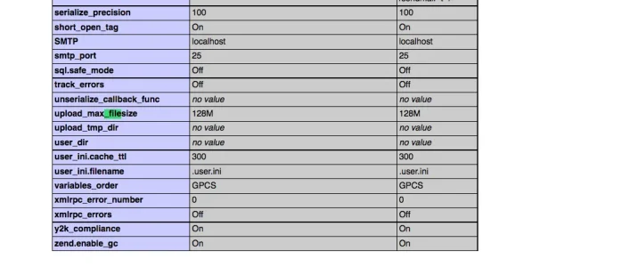

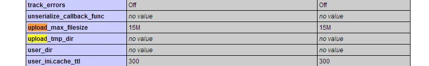

Not sure in Plesk. You can access PHPINFO via the tools URL in the ACP of XenForo.
Go to the Tools tab, and add phpinfo to the end of the URL.
admin.php?tools/phpinfo
It will tell you in there what the upload variables are
Looks like your PHP settings are correct.
I suggest contacting your host and explaining the problem. They should be able to quickly resolve the issue.

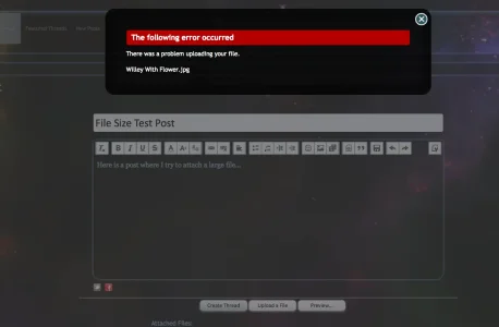

Ok, it does not look like it is on the server side as far as we can tell. Still looking talking to the tech people but we were able to upload large files through plesk and ftp with no problems to the server. Here is a step by step of exactly what is going on. If anyone has seen this before and could provide help it would really be appreciated. If we reduce the size of this picture to 25% of its original size it will work.
Here we go. It all started with a picture of my cat who like flowers. :)

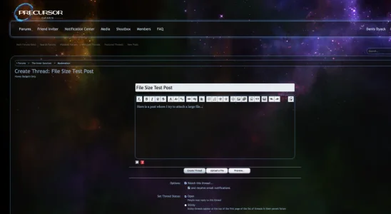

Here are the steps to upload the file that I take that is causing problems:
Create a post:

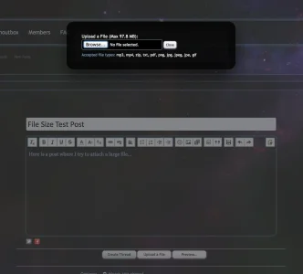

Upload a file:
Select the cat picture:
Unknown error with little info is provided :( :

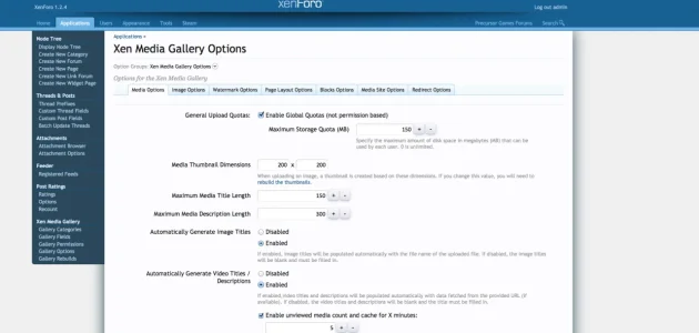

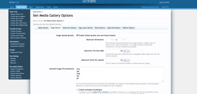

We are using @Chris Deeming 's Xen Media Gallery but the setting look fine there too.

Xen Media Gallery would be completely unrelated to the issue of being unable to upload the image to a thread. (None of my code runs there).
But, are you able to successfully upload the image to the gallery? If you get the same error it is more than likely still going to be a server issue.

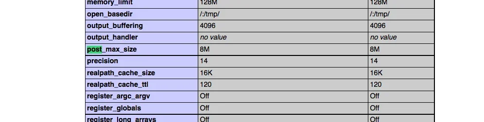

Also, you could check some values in phpinfo.
Go to:
http://precursorgames.com/forums/admin.php/tools/phpinfo
Search the page for post_max_size
What is that value?

Thanks for following up. We cannot upload files to the gallery either - this is where we first discovered the problem but then saw it seemed to be across the entire forum. We do get the same error with the gallery.
The actual file size is 3.3M and well below the limits.
post_max_size is 8M.
Not sure if that sheds any light on anything.
