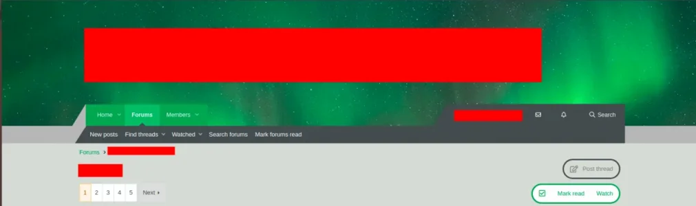

Recently, we had help filling the navigation row with an image:
which is working great when on full screen mode (Brave browser), with 100% zoom setting.

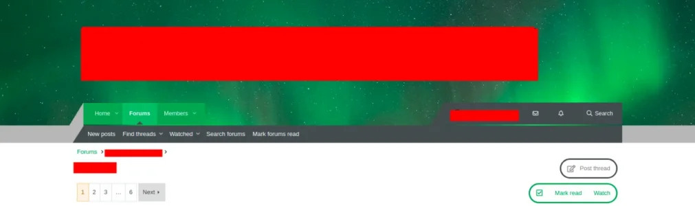

However, when we switch to half-screen mode, the following happens:
The header and navigation images are no longer aligned.

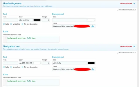

Prompted by a suggestion here, we tried adjusting the header and naviation settings, with less/css code "background-position: center top;" (and we also tried "background-position: left top;"):
Neither solved our issue though.

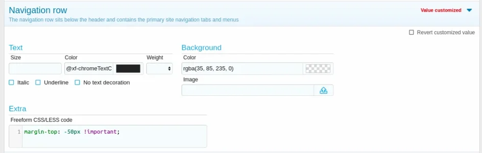

What we entered:

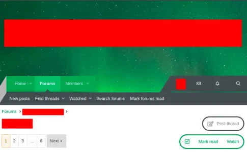

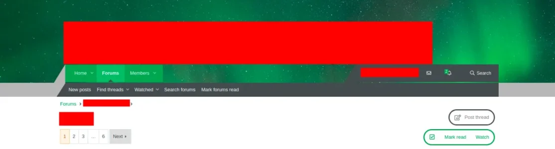

The result (full screen mode):
The second result (half-screen mode):

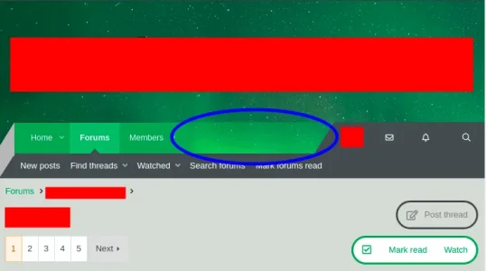

We needed to do some more adjusting (to have more padding underneath the logo, i.e., the large redded out box).
See next comment for instructions on this.

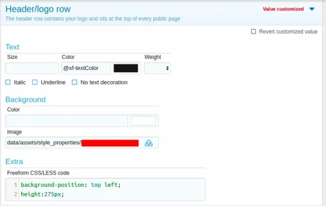

To create a larger gap between the bottom of the logo and the navigation bar, in this current configuration (i.e., using margin-top, as @djbaxter suggested), we needed to add a CSS 'height' specification to Header/log row CSS/LESS box:
This idea was found here.
In our case, the header background image (northern lights) was 1800 width x 325 height. Playing around with it, a height of 275 px gave an about equal vertical gap on either side of our logo when on full-screen mode.

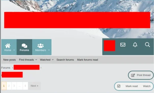

See here (full-screen mode):
This solution-path does introduce one minor 'feature' which is different from the default settings of the template and/or XenForo. When in half-screen mode, there is some sort of automatic re-sizing which occurs, so, it becomes no longer roughly evenly spaced above & below the logo. The gap below the logo becomes a bit larger than the gap above the logo.
The change in gap sizes isn't significant enough to really matter in our case (with the image size and logo size), though, in different configurations it might matter.
See here (half-screen mode):

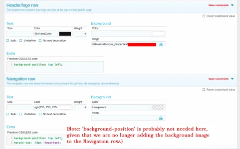

It also turns out that the Navigation row background colour must be set to be fully 'transparent' for this to work.
Like this:
With the fourth number in the rgba() number sequence being zero.

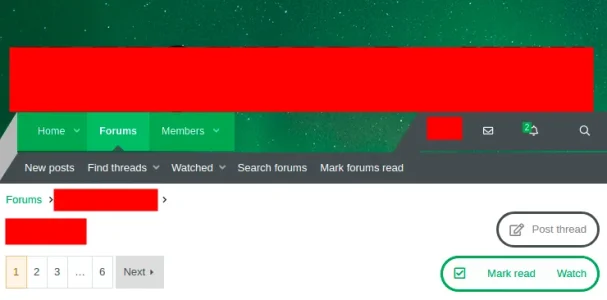

When not using the solution proposed by @djbaxter , rather, our old configuration of manually cropping two separate images for the header/navigation row such that there was a seamless fit (see one of the links in the orignal post above for more on that), or, just using a solid background for the navigation row, the logo padding between top and bottom does automatically adjust (when on full-screen vs. half-screen mode). This is unlike the solution described above.
However, @djbaxter 's solution fixes the header/navigation row re-alignment issue described in the original post above, and, it also has the added bonus of being much quicker to implement than the previous configuration (cropping two images to make them seamless is rather tedious, try it and you'll see what I mean). In other words, the gains far outweigh the loss (of automatically adjusting the logo height padding).
The images below are with the previous configuration (and a solid background in the navigation row), to show what I mean above about the logo height padding adjusting automatically when switching between full-screen and half-screen mode).
Full screen mode:
Half screen mode:
