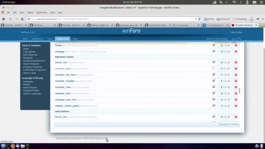

i dont have the post template modification.
attached a screenshot.
(member_card is deactivated as i manually merged it)
//edit to avoid confusion
i fixed post comments already, only problem is, that it isnt displaying a "Add Reputation" link.
You are missing the post one. Try to upgrade the mod's .xml file.
