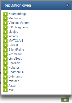

i love this reputation system but wished it worked like IP board where its a simple +/- on the right side of the post and then the rep level of that individual post is displayed(image 1), then when you click it a pop up appears with all the people who repped it and by how much(image 2)
if this addon had dual functionality of vBulletin and IPB it would be one of the best addons for XenForo
