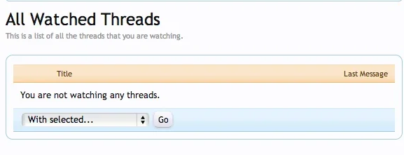

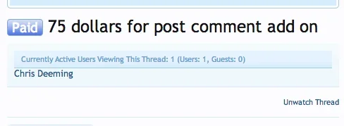

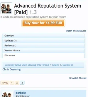

I am unable to watch threads on your "support forum"
At the top right corner of the thread that I have previously watched, it says "Unwatch Thread"
When I click on the watched thread list, its empty.
When I click this link http://www.forumservices.eu/index.php?watched/threads/all I get this message
"You are not watching any threads."
But obviously its not happening on any other forums.
Clearly its only mine and I need to set up a test forum to prove this to myself since your 100% that your addon works fine.
Maybe you still need my personal FTP access to figure out whats going on at your own support forum.
Perhaps you have another mod on your support forum installed thats causing this besides the reputation. Please let me know which mod it is so I can uninstall it from my forum.
Its unfortunate this bug can't be reproduced anywhere, I guess me and only me will be stuck with a bug on my forum.

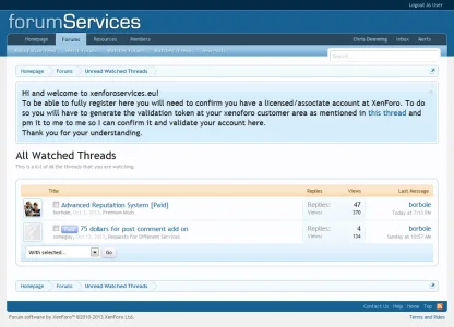

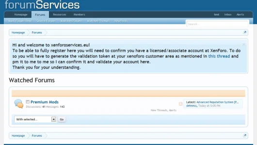

Would you mind to pm your password at my forum so I can log in as you and check it out?

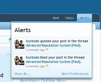

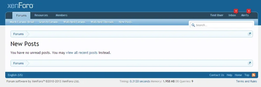

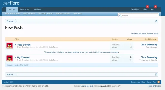

I just tested it with a test account and I did not have any issue. The account has username and password test in case other users would like to check it too.

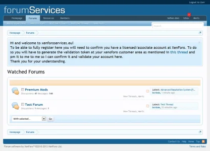

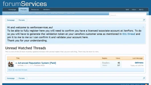

I just logged in as you at my forum and everything you claimed is not true. I don''t know why you lied but that tells me a lot about you. Here are some screenshots of your account at my forum showing all the watched threads and forums and the receive of the alert normally without any problem.

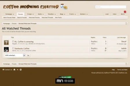

Unfortunately @Kelvin it doesn't work fine at your board.
As you can see, the member Decaf is watching this thread
Yet when Decaf checks his Watched Threads, it tells him he's not watching any threads!! Poor Decaf, he might miss some exciting comments in threads he is trying to watch.
You are welcome to log into my account "Decaf" and see for yourself. That goes for anyone who is interested, just PM me and I will give you the login info.

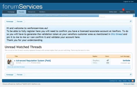

I just registered at Kelvin 's forum and to me they show just fine.
