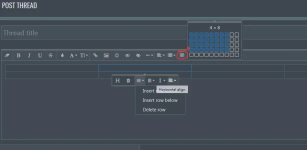

I'm primarily interested in using Xtable, but I think it will be too complicated for most members to figure out how to manually use the BB code.
Below is the current table icon from the "Editor & BB Code Manager" addon I'm using and you can see it includes some easy edit options.
However there's no way to set table or column widths, which everyone on my site complains about. I'm hoping your xtable BB codes has this functionally, but I don't know how to use the bb code.
1) Can table and column width be set with xtable?
2) Can you create an icon with edit options for it similar to the image below (xf v2.0.x)? I'm willing to pay for the update.
Once I finish Content Ratings for XF2.1, and move my own site to XF2; I plan to integrate XF2.1 native table support and the xtable bb-code together. Or at least work on an xtable editor.
The primary design goal was compatibility with TinyMCE Quattro.
Probably 1-2 months out on that

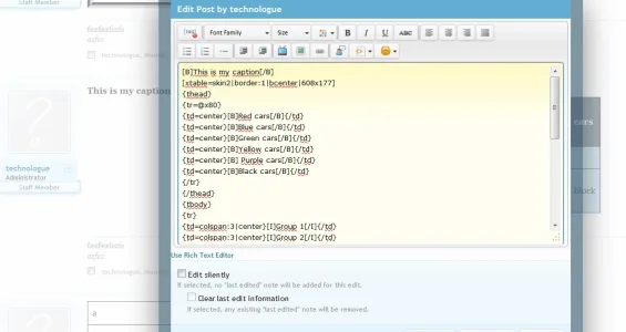

Thanks. I'll check back then. For the time being, can you provide some examples of how to use xtable?
This post has some information; https://xenforo.com/community/resources/tinymce-quattro-its-wysiwyg-bb-codes.1881/update/6195
Other wise this screenshot has a bunch, with the "multi option" behaviour from the legacy XF1 add-on;
Note; the upcoming v1.1.x release (~1 month or so) should cleanup some of the behaviour so it supports native XF2.1 tag options;
{td colspan:3 text_align:centre}[I]Group 1[/i]{/td}

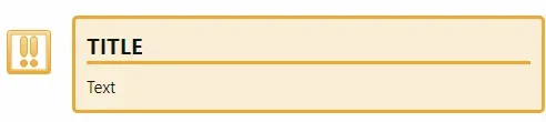

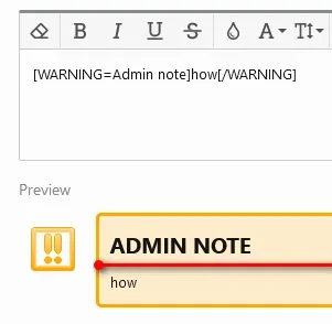

@Xon pop-up dialogs are not added correctly after adding title, this show in two line.
203814
This should be show in one line.
203815
Also can be add separate line for title?
203816
Yeah, known bug. I haven't looked into how to fix it yet.
So you add css something like;
CSS:
.mod_interrupt--warning .title
    border-bottom: 3px solid #ffa500;
Which gives;
203829
Not actually too sure how how to make the title stretch the full width.
