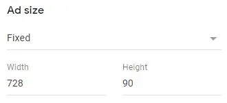

Then if you have an Adsense ad set as fixed in the adsense settings:
Then your code should look like here: https://xenforo.com/community/threads/ads-manager-2-by-siropu-paid.142629/page-61#post-1364007

Try setting a width (instead of max-width). Change your css to this:
CSS:
.centred {
    width: 320px;
    height: 50px;
    margin: auto;
@media all and (min-width: 480px) {
  .centred {
      width: 468px;
      height: 60px;
@media all and (min-width: 741px) {
  .centred {
      width: 728px;
      height: 90px;
...and change data-full-width-responsive="true" to "false". Also, if you are testing a lot you should also add: data-adtest="on" into your ad code so Google doesn't ban you.
See if that gives you the results you're looking for.
