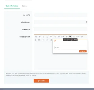

and please remember, if you can add the drag image system to the ad generator for advertisers, it's horrible to add images from links, it is horrible to make new topics and have to put the images with links without the possibility of attaching them as it is done from the common editor

Are you referring to promo threads?
yes
if I don't have something wrong, just let me add photos through links
many advertisers do not use this system because it is not comfortable and have to use pages where to upload photos... the drag image system is much simpler, as well as effective.
Currently, no. I would have to add a new option to exclude certain URLs.
