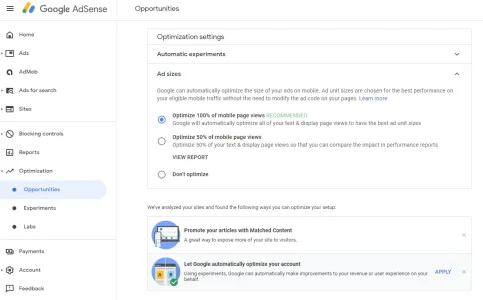

I had a fixed size 300x250 Adsense ad installed using this addon, and it was showing much larger ads than that, similar to if it had been responsive code.
Is there any setting for "Code" ads in this addon which would override the size setting on the ad code, for example does it matter whether I choose "Display without wrapper"? Or could the "Size" setting for the ad in the addon override the actual size specified by the ad code?
Is it a responsive adsense unit?
No, it is a fixed 300x250 adsense unit

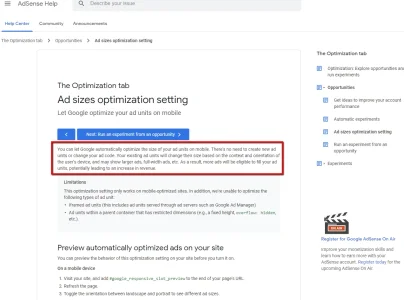

If your fixed size units are bigger than the set size, then it's an issue with adsense. Please provide your board URL to take a look.
I figured out the issue. The "Optimize 100% of mobile page views " setting in Adsense allows Google to override the ad code set size on mobile.
