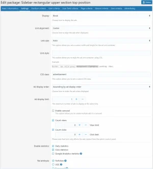

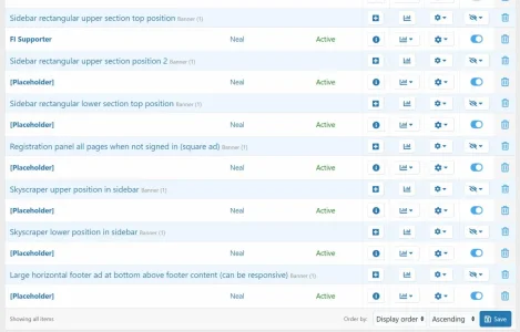

@Siropu I setup my next site at https://flightinfo.com and cannot get the ads to order properly such as "sidebar above". As you can see on the right side I have an ad to become a FI Supporter which I want at the top of the sidebar and then the square below that and then skyscraper. I have each of these packages set to order by Ascending by Ad display order but I must be missing something as I cannot get them ordered at all like I want. My other site at https://rvforums.com seems to be working but maybe that's by luck? How can I arrange multiple packages in "sidebar above" such as I have 3 packages for 1, 2, and 3 positions?
If you have set ad display order to "Ascending by Ad display order", have you set the display order for each ad accordingly?
Seriously, why do you always have to find my mistakes haha! Dagnammit, how did I overlook that so many times??? I was using the package display order and thinking that was the number.
Thank you @Siropu!!!
