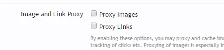

Make certain you have the tabnabbing config set to "false" above, and disable XF's link proxy feature as well. Both can interfere with link rewriting.

I haven't set tabnabbing to "false", where do I do this? Also, where do I disable the proxy feature?
I've rarely had the check function on their site work--I checked two of mine just now where it has been working for years, and it does not detect VL. It'd be better to add a few links, click them, and have them check to see if they have detected the clicks.
Link proxy is disabled by default, I believe. You'll find it under Options -> Messages, about halfway down. Make sure the box is unchecked.
