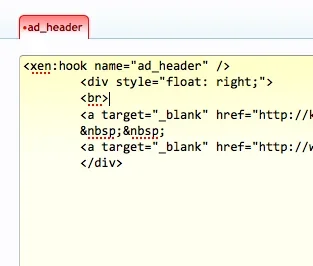

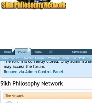

When i add the following html in ad_header template, these two white arrows from the breadcrumb show up awkwardly only in responsive mode... in desktop view all looks fine... i remove the html and these do not show-up. i can see these arrows in my mobile device as well... no idea how to get rid of this thingy. o_O
Any suggestion?
Thank you so much!
<xen:hook name="ad_header" />
    <div style="float: right;">
    <br>
    <a target="_blank" href="http://khalsaaid.org/"><img width="190" height="61" src="/images/adverts/khalsa-aid.jpg"></a>
    &nbsp;&nbsp;
    <a target="_blank" href="http://www.gursoch.com/ "><img width="190" height="61" src="/images/adverts/gursoch.gif"></a>
    </div>

That is very likely related to your header height:
Admin CP -> Appearance -> Style Properties -> Header and Navigation -> Height of Header Logo
The header height is usually fixed and expected to stay the same.
In your case the fix is probably to increase your header height to accommodate those images (at least 61px, maybe more). Just keep increasing the height until the problem goes away.
You need to add a media query to offset for the ad banner:
@media (max-width:@maxResponsiveMediumWidth)
.Responsive #headerMover #headerProxy { height: 359px; }
Ads disabled on the page it shows fine(without the query)
@Jake Bunce @Russ
Sorry for being PIA but this did not do anything! I am a complete novice at this... After adding the code in extra.css what else am i supposed to do, is there anyway to hide these banner after a certain browser length, thanks
Woohoo! Finally, the following code seems to working fine for me... (y)
