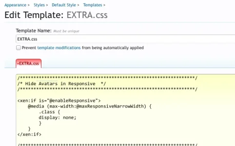

So this is the code in EXTRA.css
But avatars to the left of threads in mobile remain.
Are you able to advise what I'm doing wrong?

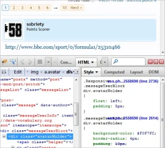

Right click and open the browser inspection tool.
Try using .avatarHolder.
Actually though, I would probably use: .Responsive .messageUserBlock div.avatarHolder.
When you do that though, you will also need to remove the left margin from this: .Responsive .messageUserBlock h3.userText.

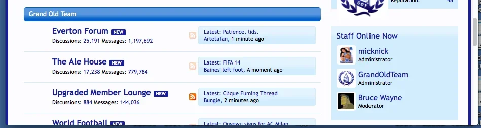

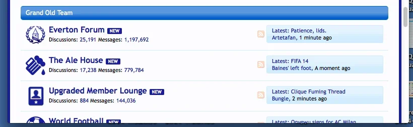

On this, I've noticed a bit of an odd issue. It prevents Node Icons being displayed on any width over 600.
So 600 width and below, node icons show;
But 600 plus, they disappear.
Definitely isolated to this code. Does this happen to you?

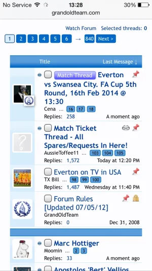

From the discussion list and thread list is all I really want to hide. That makes it a very sleek mobile edit. The issue I'm having is I don't know where to remove the left margin. I put it in extra.css with the above code but that didn't work.

The class is .messageUserBlock h3.userText on a desktop. I can't inspect elements on a mobile device so I can't see what the padding is on mobile.
The attached pic shows the part that I want to remove, the circle part. I tried the above code which removed the H3 text completely so I know I'm on the right track but I can't figure it out.
