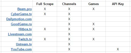

@Jaxel - In the update today you mentioned that you "fixed a Bug w/YouTube scraping." - Does this mean that YouTube channels are "now" scrapeable?
