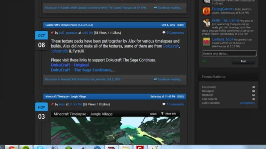

Hello, can anyone share some light on why this is happening? The title bar with the date and edit buttons seem to be overlapping the square behind it. I've only just installed the flexile dark style. No modifications have been made. I've also just tried the normal flexile and it does the same thing. Anyone got any ideas?
I am guessing this is how it looks? You can change to your desired by edit the template(s)...
It's an option in the RecentNews block : "Push Date out of Block : If selected, the Month/Day div will be pushed slighly outside the block."
Just go to
AdminCP Home > Blocks > RecentNews item
and uncheck the corresponding option.
Just go to
I think he's referring to something other than the date block :)
It looks to me like an issue with the way the flexile theme is defined rather than a XenPorta problem. The subHeading class is usually contained within the boundaries of the primaryContent class in most styles I've seen with XenPorta installed. It can probably be fixed by adjusting the padding but I think those classes are common to the forum (I could be wrong) so any changes would impact elsewhere.
A link to your forum would be helpful or failing that I'd leave a post in the theme theme discussion thread.
