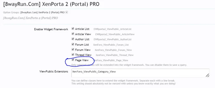

first go into Xenporta 2 options and make sure Page View got a tick.

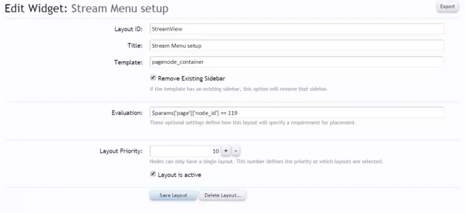

after doing that are we interested in going into the tab called "Layouts"
and create a "new layout"
you will need to put in pagenode_container in the box called Template, the rest doesn't matter and the Evaluation should just be left blank, that's only for doing a bit more specific setup.
you can read more about the advanced "Evaluation Arguements in his FAQ
With that being done should you simply be able to fill out the Layout as you so please.

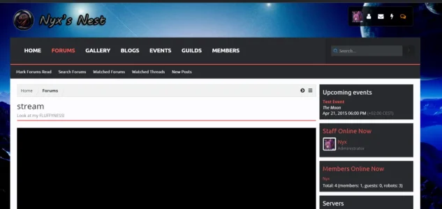

And the end result in my case ended up looking a bit like this
