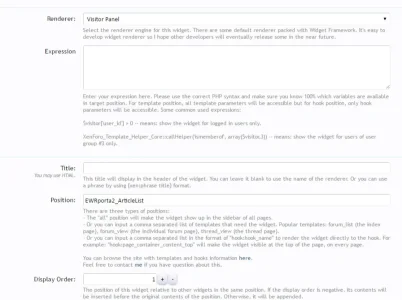

try adding the bd widget "visitor panel"
and also try disabling all the XP2 widgets if any are activated.
Well I disabled all the XP2 widgets and added the bd widget "visitor panel". All I could see were the xp2 promoted articles stretched out, no column for widgets.
I feel like I have another setting set wrong somewhere...
