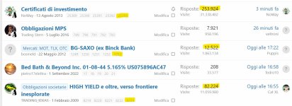

On our forum we have threads with even 250k answers. We allow 10 posts per page, therefore we have threads with 25k pages.
I attach a screenshot.
How does Xenforo manages this? Is it a problem, or is irrelevant?

Such large threads are exceptionally rare, and while there could be some performance impact, it is unlikely to be the cause of your SQL problems.

On our forum they are common, like 40% of the active threads (our users use a thread like a chat, we have 36.280 users, 78.341 threads, 5.881.545 posts). Which could be a "good" limit of posts per thread? I ask this even if it is not the cause of our problem.
