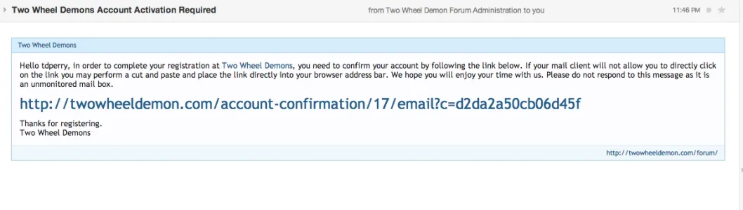

Nope... not an xF problem... just registered on my forum using my yahoo email and got this

This is what my postfix mail log showed for my VPS
May  9 23:46:51 twowheeldemon postfix/pickup[13870]: C02D91F390: uid=33 from=<webmaster@twowheeldemon.com>
May  9 23:46:51 twowheeldemon postfix/cleanup[14306]: C02D91F390: message-id=<20130510044651.C02D91F390@twowheeldemon.com>
May  9 23:46:51 twowheeldemon postfix/qmgr[3314]: C02D91F390: from=<webmaster@twowheeldemon.com>, size=4252, nrcpt=1 (queue active)
May  9 23:46:53 twowheeldemon postfix/smtp[14308]: C02D91F390: to=<tracydeanperry@yahoo.com>, relay=mta6.am0.yahoodns.net[66.196.118.33]:25, delay=2, delays=0.02/0/0.86/1.1, dsn=2.0.0, status=sent (250 ok dirdel)

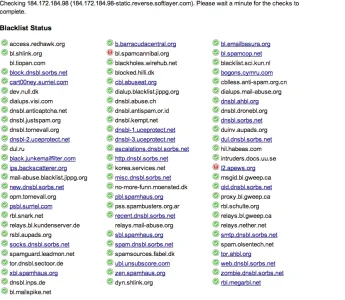

What is the domain or IP... I can check to see if it's blacklisted real quick.
Here's the domain http://prepaidcellforum.com. Forum is new and still in construction..
Appreciate the help.
I see, so that's probably the reason. Hmm. Can I ask my host to change IP? It could fix the problem.
I know recently we had a new forum owner have problems with FaceBook not allowing connections (apparently because of being in the blacklist). Their host changed their IP to a clean one and they had no further problems. It's worth getting into a chat on their support page and asking. The two that are listed are not major blacklists (well, apnews.org is not a minor one) - and they probably aren't causing the problem, but I would eliminate all chances.
