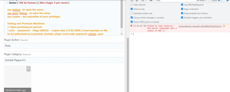

@Chris D Today i purchased your product manager,but when uploading attachments it gives error 403. What might cause this ?
Some permissions needed on some folders??
Thanks.
Does it happen with all files? Does it happen if you try to attach the same file to a thread?
This shouldn’t really be any different to uploading any other attachment, it’s basically the same code.
Would be wort checking the server error log in case there are more clues in there.
Thanks.

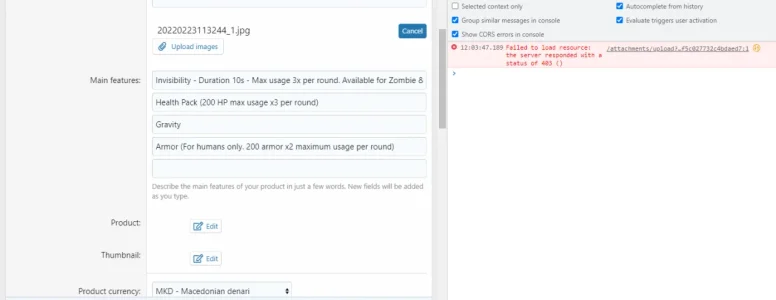

It happens only when adding attachments in product, if you wish i can give u credentials.
I get 403 error in console which logically means something with permissions is not right...
@Chris D
It happend in attachments in forums too..
That now makes more sense.
So it could be permissions for example if the data/internal_data permissions aren’t recursively set properly.
But it could also be something security related on the server side. We’ve seen things like mod_security (and similar) be configured so stringently it would block certain files, for example.
As this doesn’t appear to be specific to this add-on you’re more than welcome to submit a ticket or post on the forum but some sort of server config issue seems likely at this point.
I fixed the problem by disabling ModSecurity on my site. And the problem is gone.

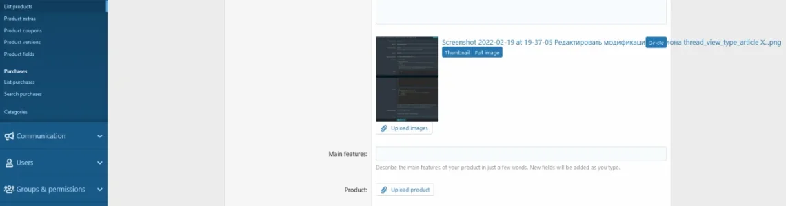

@Chris D , Hello!. Long filenames are not truncated when uploading attachments.
  • Screenshot 2022-02-24 at 11-42-54 Add product Development for XenForo - Admin control panel.webp
Not something I recall seeing before and I don’t think we’ve had other reports.
Does it happen with every product or does it still happen if you release a new version for this product?
I have no idea, everything else was working fine....
