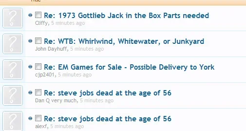

Is there a way that i can remove.disable the "last message in the thread belongs to the same user" condition?
Reason is this
I have a forum that currently isnt working properly, so therefore using an RSS feed. Therefore i tend to get the following:
Now ideally i'd like to be able to merge the two identical threads (unfortunately there is not a "Re:" in the first thread - do the titles need to be identical???? it's always the same prefix every time...
Cheers
