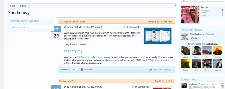

Found this display bug. You could probably fix that just by instead of using float-left, use absolute positioning and give it a z-index.
Or you could just un-check "Push Date out of Block"
(That's the amateur solution to that, I know)

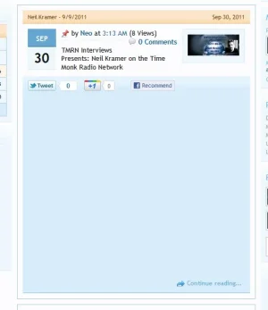

I've run into this issue with v 1.5.0 in Internet Explorer. If I show social media options in the Recent News block, it displays extra space at the bottom of the first post. Turning off the social media options fixes the problem. It only does this on the first post and only with IE. Firefox and Chrome display fine.
Social Media checked -
With Social Media not checked -
Replace EWRporta_Block_RecentNews.css with the following and tell me if that fixes it:
.recentNews .subHeading { margin: -10px -10px 10px; }
.recentNews .subHeading a { color: @subHeading.color; }
.recentNews .messageUserBlock { float: right; margin-left: 10px; }
.recentNews .newsDate { float: left; margin: 0px 10px 10px 0px; padding: 0px 10px 5px; width: 35px; font-weight: bold; text-align: center; }
.recentNews .newsDate .newsMonth { padding: 10px 0px 5px !important; margin: 0px -10px 5px !important; text-transform: uppercase; }
.recentNews .newsDate .newsDay { font-size: 26px; }
.recentNews .leftDate .newsDate { margin-left: -45px; }
.recentNews .leftDate .newsText { margin-left: 25px; }
.recentNews .messageContent { font-size: 13px; }
.recentNews .messageContent .postedBy { margin-bottom: 10px; padding-bottom: 5px; border-bottom: 1px dashed @primaryLighterStill; }
.recentNews .messageContent .username { font-weight: bold; }
.recentNews .messageContent .posted { background: transparent url('@imagePath/xenforo/icons/sticky.png') no-repeat left bottom; padding-left: 20px; }
.recentNews .messageContent .comments { float: right; background: transparent url('@imagePath/xenforo/widgets/discussion-new.png') no-repeat left bottom; padding-left: 20px; font-weight: bold; }
.recentNews .messageContent .clearFix { clear: right; }
.recentNews .sectionFooter { margin: 10px -10px -10px; text-align: right; position: relative; }
.recentNews .sectionFooter .continue { padding: 6px; font-size: 12px; }
.recentNews .sectionFooter .continue a { background: transparent url('@imagePath/xenforo/icons/redirect.png') no-repeat left bottom; padding-left: 20px; }
.recentNews .sectionFooter .continue a:hover { text-decoration: none; }
.recentNews .sectionFooter .source { padding-top: 6px; float: left; }
.recentNews .sectionFooter .sharePage { position: absolute; }
.recentNews .sectionFooter .shareControl { margin-top: 4px !important; }
