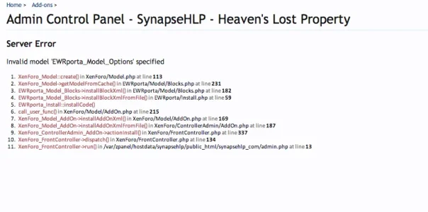

Getting this error when trying to install the latest version of XenPorta fresh after uninstalling the old version. Deleted all files associated with it as well.
Hopefully I'm posting in the right section. Still a noob.
Any ideas?
It's been asked a couple of times but never answered. I would completely uninstall and delete the files. Double check that all EWR* tables have been removed from the database. Then re-upload all your files and reinstall.
Yeah just uninstalled 1.6 all together and went back to 1.5.9. It's in the process of installing now, no error. Appears to be a bug in the version, but must have a trigger if not everyone is experiencing it.
I read this:
Enable Debug Mode in config.php > ACP > List Add-on > XenPorta > Controls > Edit > Uninstallation Code > Remove both the Class & Method > Save > Uninstall
Add this line in your config.php if you don't know how to enable debug mode:
$config['debug'] = true;
