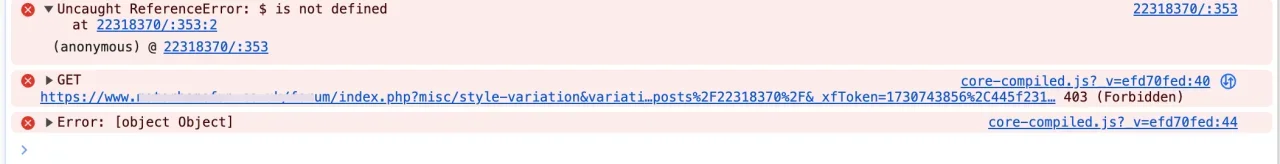

I've only seen this on a single client's site, but I'm not sure what to make of it. We upgraded their style to 2.3 with variations enabled. They disabled the old 2.2 version, switched everyone to the new 2.3 version. Various users when switching to the dark mode get the oops error, with this in console:
The strange part is when the user switches to the default XenForo style, then back, they're able to use the variations then.

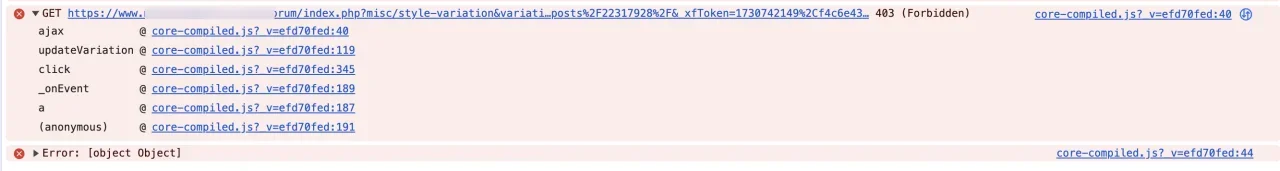

You could check if a firewall or proxy is blocking access to the URL or if there are any permissions set on the server that might be causing this restriction since a 403 error is returned.

A 403 error is a web server error, happening outside XF.
It will most likely be due to some sort of security mechanism.

What happens if you try to load that URL only? Do you see the Cloudflare branding page?
Cloudflare usually serves 403 responses if the request violated a default WAF rule enabled

OK I just had another user report it, and I logged in as him and got the same error. Checking in Console. The first error is different. from above, Uncaught Reference error.
Chat GPT tells me
This indicates that your code is trying to use $ (typically the shorthand for jQuery) but cannot find the jQuery library loaded in the environment. This usually happens because jQuery is either not included or not loaded before your script runs.
So why might some users have jquery loaded OK and others don't, and why would it be loaded for them after they visit the default theme?
OK, the Uncaught Reference thing was nothing to do with it.

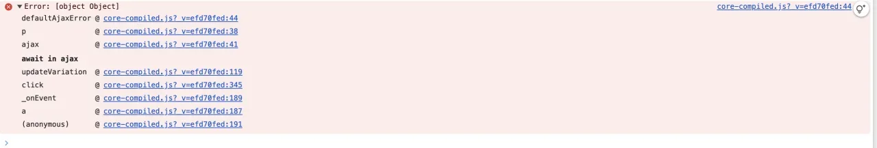

Russ spotted when digging deeper in to the error that, somehow, the affected users were still browsing in the old deactivated style. How? No idea. But once we deleted the old style the issue was fixed.
I'm seeing the same issue after upgrading to XF 2.3.
After the upgrade we switched to the XF default style and disabled the previous custom styles. It does seem like the members are somehow stuck in the old style and picking ANY style variation throws the error message.
I will delete the old inactive styles and report back.
