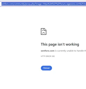

EDIT: my embed breaks the xen proxy?
referenced url.
