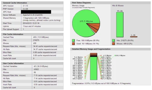

apc.ini settings:
extension=apc.so
apc.enabled=1
apc.shm_segments=1
apc.shm_size=128M
apc.num_files_hint=7000
apc.user_entries_hint=4096
;apc.ttl=7200
;apc.user_ttl=7200
apc.gc_ttl=3600
apc.optimization = 2
apc.slam_defense=0
apc.stat=1
apc.include_once_override=0
apc.enable_cli=0
apc.file_update_protection=2
apc.max_file_size=2M
I would really appreciate if you can help me with my problem :)
