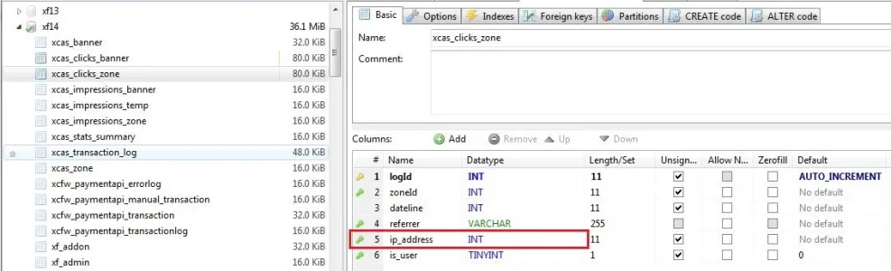

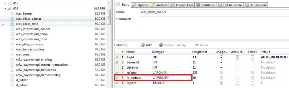

Fix (Temp):
The primary problem here is that the 'ip_address' field in the xcas_clicks_zone table is set to 'INT' for the datatype. The script looks to push a write that expects that field to be set as "VARBINARY".
By changing the the datatype to 'VARBINARY' (same as the other table xcas_clicks_banner) the script works properly when someone clicks an ad.
It seems to work on my test environment, but I'd like @XCentral to confirm the function.
Use this fix at your own risk. :)
Edit: I realized that the field length was set by myself after I changed the data type, so that's my edit and I removed that from this post.
Probably should consider adjusting to match, at least.
Adding some supporting screenshots:
Working Table:
Not working: (fixed after fix I noted above)

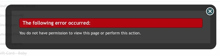

Ok... it won't let me embed a banner now, as in, it won't give me the code when trying to embed a banner. No error log generated, just:
Thanks... sorry, I just seen that and was about to delete the above post. Wow you're quick. Really impressive support for your products XC.

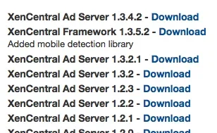

Also... could you please put the 1.3.3 versions in the download area, as I have reverted mine so it works correctly, but you haven't listed the 1.3.3 versions.
YES PLEASE. Unknowingly and unexpectedly I commented to selling an ad to a new client that I cannot even enter in now.
