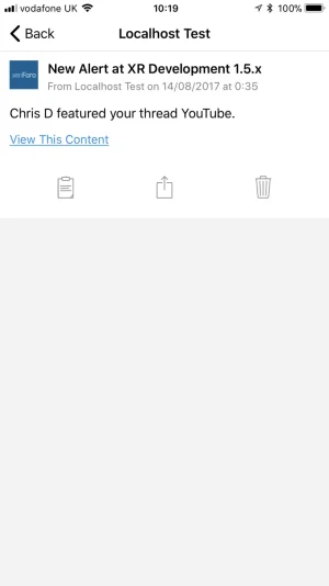

BTW, I hadn't forgotten about this, and I thought we had discussed it before, but maybe I'm mistaken.
Anyway, the upshot of my testing when this originally came up was that I couldn't reproduce it. Considering my hazy memory about whether we actually discussed this or not, I just tried again with the latest FT and latest Xen Pushover and I still can't reproduce the issue.
If you can produce it reliably, please run through the reproduction steps again in more detail in case I've missed anything. Thing is, all this alert stuff is fairly simplistic and there shouldn't be any fathomable reason as far as I can work out for that part of the alert to be missing.
Hey Chris, thanks for getting back to the issue. There are no real steps to do beside that the alert of "Admin featured your thread xyzxyz." (which is displayed correctly in the alerts on the forum) is then pushed by Pushover as "Admin featured your thread ." So the thread name is missing entirely but there is a space and the dot of the end of the sentence. So the thread name is not pushed and is missing. CTA Featured Thread is the only add-on where this happens. Everything else is pushed correctly and completely.

It’s not something I’ve ever been able to reproduce and no other reports of it.
I’ll do some more testing.

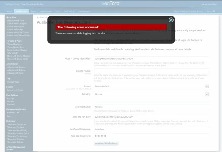

Not working for me for XF. Gives me a warning message that says There was an error logging into the site
According to your add-on list in the Admin CP, which version of the add-on do you have installed?
I can’t see why that would be happening and can’t currently reproduce the issue.
Did it work prior to version 1.2.3?
@Martok or anyone else any similar issues?
@Chris D it's working again now that I have installed 1.2.3, I've had several Pushover alerts from this site since I upgraded.
